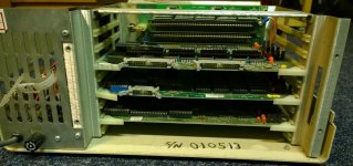

Today I've picked up an old TEI S100 system. It has a 8085 CPU. The previous owner used
it for a decade as an external floppy drive on an IBM compatible machine... How low can you go.
Well it probably saved the machine it's live... :-)
The machine has a very, very nice construction. A pleasure to look at.
Unfortunately the floppy controller is missing. There are only a CPU , I/O and memory board.
The drives are MPI B52 models. DSDD, that is why they could work on an IBM compatible...
I found out that Tei had an FDC-2 and FDC-3 floppy controller card. The FDC-2 has
an 1771 and the FDC-3 an 1791. I would expect that the machine had an FDC-3 controller
because only this controller could use the full capacity of the floppy drives...
But FDC-2 or FDC-3, it doesn't matter. I can't find any software for this machine.
Does anyone have software images for these Tei machines?

Nice find! As you've noted, TEI did make some really well built boxes, I've got one of their smaller units...10 slots I think? CVT like yours, but the CVT in mine is *very* loud, almost like there's a loose lamination or something. I've got an 8080 CPU and 16K of TEI static RAM in mine, those are the only TEI boards I currently own.
I've avoided buying a TEI floppy controller for the same reason you've encountered -- no software, no documentation! There are many examples of customizing CP/M for 1771 or 1791 FDCs of course. I'm currently using a North Star MDC-A4 single-density hard sectored controller in my TEI chassis, when I use floppies with it.
Thanks for your reply! This is your cpu card?
http://www.glitchwrks.com/2016/05/31/tei-8080-cpu
Interesting to see that jump address. I guess you can jump to the
start address of a floppy controller or an address on an eprom board?
There is a dipswitch on my cpu board, and an 2716 eprom.
I don't think the dipswitch is for a jump startaddress. But maybe there
are a few preset jump addresses in ROM selected by the dipswitches?
I want to read the rom to check what's in it. My programmer
can read only 2732 and bigger. So I have to make a little converter.
Regards, Roland
Yes, that's my CPU board! The jump address lets you jump into whatever code you like, a monitor EPROM or a bit of boot code, et c.

I've been looking at the cpu board for a while. And figured out that the
8 dip switches are for address setting. Funny how a few addresses were swapped.
The read out is done by two DM74L85s.
The switches in the on state give a zero. The address seems to be set at F0xx
I wonder, what would this address be? The floppy start address? Or the EPROM address? Or...?
S1 = A15 (off = 1)
S2 = A12 (off = 1)
S3 = A14 (off = 1)
S4 = A13 (off = 1)
S5 = A11 (on = 0)
S6 = A10 (on = 0)
S7 = A9 (on = 0)
S8 = A8 (on = 0)
Regards, Roland
Hmm a short test... I've put in E800 (Northstar FDD controller start address) with the switches.
Pulled out the CPU board out of my Northstar Horizon and put in the Tei controller.
After hitting reset the floppy starts to read. So then I think it is a Jump address...
I don't see anything appearing on the screen. I guess CP/M crashes because
this board has a 8085 and not a Z80...
But why on earth is there an eprom if there is a jump address? The original address
setting is F0xx. So I wonder if F0xx is the start address of the eprom...
I think I'm going to burn a jmp E800 in an eprom and see what happens then.
Sadly no documentation at all about these Tei CPU 85 boards...
Regards, Roland
CP/M will run on an 8085, but if you have a version that does use Z80 opcodes, yes, it will crash! North Star DOS will also work with an 8080/8085 unless it has been customized for a system with a Z80.
The EPROM may be a ROM monitor, to allow doing system maintenance without having to boot a diskette. Many ROM monitors are like this, and also support jumping to a floppy boot routine (looks like yours does that, since you found a string asking which floppy to boot from).
So I've put in an EPROM C3 E8 00. Lets see. Nope.. Nothing...
And then I thought, hey there was something about that address. Low Byte first then the High Byte.
So tried again. Now with: C3 00 E8 in the EPROM. And yes! The FDC starts to read!
The dip switches on F0xx seem to be the start address of that EPROM.
So you can use this board without EPROM and just put in a jump address to a FDC controller or whatever.
Or you can put in a monitor program or whatever in that EPROM and just set F0xx in the dip switches....
Well, I've no idea if and how the CP/M for the Northstar is optimised for the Z80. My first guess is that it is optimized
because the Northstar primary is a Z80 machine. (As far as I know never sold with a 8080, please correct me if I'm wrong.)
I don't know if I have NS-Dos. Have to look...
Yes you are right. After turning on this machine if should display that message before booting at all.
The little problem here: Nothing shows up on the serial port. Maybe this has something to do with
the missing floppy controller.
At lease I know now how to use the CPU board.
