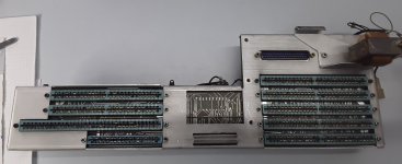

Also, for completeness sake, some pictures of the backpanel.
Note that this particular example has bad / dirty contacts in the connectors. Replacing them is not an option due to the dual PCB construction. I expect trouble when trying to run this unit....

With the finished schematics of backplane and decoder it is on with the hardware itself : fixed mains switch and tempguard, reconditioned main caps, checked main transistors, and presto : +5V is present ! Sometimes its easy....
But always keep in mind that the design is really very dangerous. Need to fix a bunch of broken wires on the voltage connector, and then replace some mechanically damaged transistors and some RAM's that have fallen victim to a mouse.
