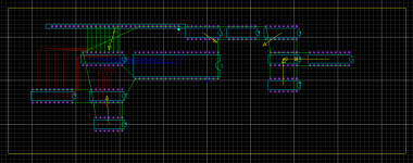

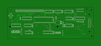

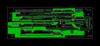

bottom underway, i know people will build modern better versions, i like to have a close replica also. i still need to go over it with a fine tooth comb from the high res imagesfdc bottom.JPG
@Klyball, are you duplicating @snuci’s board exactly and then adding the jumper wire and cutting the trace just like @snuci’s board? Or will you mod the traces to incorporate the fixes applied to @snuci’s board?
