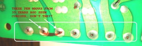

Well ,a little late in following up on this but the real world collided with some frustrating testing and uncertain results.
Anyway, a couple of problems were found and -- at first -- they seemed to resolve the issue but continuous testing saw the bad machine lurch back into its realm of misbehavior. Specifically:
(1) During testing, it was noted that "light, inadvertent jiggling" of the connector from the DC power supply supply to the motherboard and the floppies caused the machine to blink on and off. (That is, power down and back up rapidly.) I inspected the PS board and found evidence of some bad stress joints of the connector. (Pics below.) All of the joints were re-flowed and, needless to say, the pins were polished and corrosion removed. The Molex connector was cleaned with contact cleaner and a toothpick was used to scour the "holes".
Further vigorous stressing the connector did not re-occasion the intermittent behavior.
(2) After the testing, the machine behaved normally; that is, I was able to log into the B: drive, execute programs from either drive without incident -- for a while. Gradually, the problems returned. I was able to execute a DIR command on the A: drive successfully but no longer to do a "DIR B: command or execute programs on either drive. Basically, it appears as though the drive light turns on indicating it is selected but the drive does not read. Also note that testing discontinued (that is the machine was allowed to "cool down") but immediately upon resuming testing, the problems evidenced themselves again.
(3) At this point, it's no more Mr Nice Guy. I measured the PS voltages to the motherboard and the drives and noted:
(a) Motherboard at 11.8 VDC, and 4.8 VDC.
(b) A: FDD essentially the same.
(b) B: FDD essentially the same.
The low voltages are puzzling (i.e., NOT 12 VDC and 5 VDC.) and perhaps these should be higher. Does the PS have problems? Dunno. Did not measure the FDD voltages with the drives running but there has to be some draw down with the drives sucking current to operate.
..so, attention turned to the PS and the wiring harness for tomorrow. No need to respond; I am just updating the thread to be helpful for others who may need help with similar problems further down the road.
