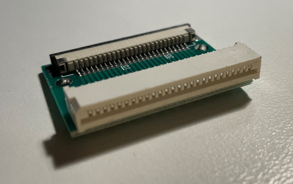

What is the width of the connector? If it is ~26.0 mm, it is a 1.00mm pitch 26 position FFC cable. If it is significantly larger than 26.0mm, then it is a 1.25mm pitch 26 position FFC cable. 1.00mm is much easier to deal with since it is a modern standard. 1.25mm is no longer a standard that anyone uses and hasn't used since the mid-90s. If it is 1.00mm you have your choice of options, including 1.00mm direct-drive floppy replacements. If it's 1.25mm, your first stop is going to be a 1.25 to 1.00mm FPC cable or a 1.25mm to 1.00mm FFC adapter so you can be compatible with any of the modern options (or a rather expensive 1.25mm to 34 pin adapter sold by one company that charges outrageous shipping if you don't live in Europe, but I discourage people from choosing this option just due to my distaste of shipping costing the same amount as what is already an overpriced piece of simple electronics)

The company is:
This is the 34 pin to 26 conductor you would need if it is indeed 1.25mm:
This is the 34 pin to 26 conductor you would need if it is instead 1.00mm:
If you just want to get the 1.25 to 1.00mm adapter board instead, assuming you are dealing with a 1.25mm interface, this is what you would want:
There is a guy on what I understand to be like something like the Polish version of eBay/Craigslist that also sells the same adapter for far less:
I have encountered a case recently involving a Toshiba floppy that was similar to your situation and a slight modification of the 34 pin to 26 conductor adapter was necessary in order to make it work with the Toshiba system. The required modification is the need to jumper position #8 on the 26 conductor interface, to Ground, because the Toshiba systems place the Ready signal at position #8 which is very odd, and most adapters are not wired to deal with such an unusual situation. Without jumpering position #8 on the 26 conductor interface to Ground any attempt to access a floppy or floppy emulator through the adapter would always return a "Drive Not Ready" error.

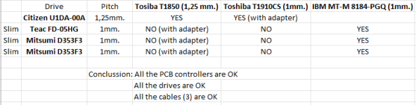

Bad news: after after several tests with two different flat cables and two floppy drives, I realized that the problem is the floppy controller itself. Sometimes it issues a reading error message, sometimes shows a message saying the the floppy cannot be read, etc..
