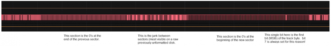

Let me be specific by what I mean by issues. I've written a tool called testindx.com that measures the number of microseconds between the sector good and the first sync bit in the sector. Essentially it measures each sector (0-31) and shows a graph.
I'm attaching two disks each tested in both drives.
The first thing I need to say is that these are repeatable - if I analyze the same disk in the same drive - the graph and results will be the same. Some results are like disk 1 between the two drives, graph is different, but the spread is about the same. disk 2 has a wider spread to where it is messing things up - it would fail trying to read the track in drive B because of what is going on.
The repeatable part of this is what I find interesting. The 3.5" drives did the same thing. I am starting to wonder if part of the direct drive is responsible for this - in other words, for each revolution could there be strong spots and weak spots in that drive where it speeds up and slows down in the same place in the rotation.
