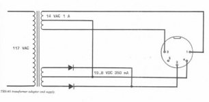

Your External Power Supply just needs to supply +5.00 VDC, +12.00 VDC, and -5.0 VDC. I assume that is what you have wired to the
Model 1 from the External Power Supply.
