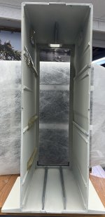

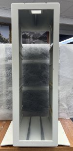

Now the case...
Front
Front right inside side - IBM Vertical Case
IMG_0812.JPG - Right inside vertical case
A closeup of the inside channal that the computer slides in on.
Bottom Glides
I put tape over the left hand glides so to not scratch the top of the inside case. The case does not touch the bottom glides if you are carefull and get the nylon runners on the bottom of the inside case hooked to the right side channels.
Bottom of inside case showing the nylon runners.

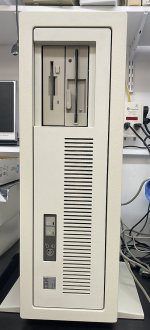

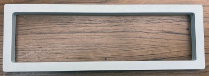

Front side of bezel.
IMG_0819.JPG - Click image for larger version  Name:	IMG_0819.JPG Views:	0 Size:	220.9 KB ID:	1217160

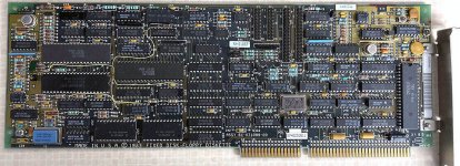

IBM Fixed Disk and Diskette Drive Adapter (first generation)
IMG_0747.JPG - Click image for larger version  Name:	IMG_0747.JPG Views:	0 Size:	222.1 KB ID:	1217163

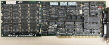

AST Advantage Premium MIO Card. It has 1MB for extended memory, printer and serial ports.
IMG_0742.JPG - Click image for larger version  Name:	IMG_0742.JPG Views:	0 Size:	237.0 KB ID:	1217166

Nice.
Just in case you don't know: you can rorate the IBM badge so that it matches the vertical position.
  • Like
Reactions: HKG
I've taken badges off several old PC's because they were worth more than the rusted case was. I really don't see the point of turning the badge but thanks for the idea, maybe in the future.
Strange as it seems I was working on getting an DOS FTP program working on this machine today and it connected and worked on an old site of mine that I've been unable to log onto for months. I've even been unable to use the terminal associated with my service provider. WIN10 ya got to love it...:rolleyes:
What I meant is that IBM designed the badge to be rotatable - without having to remove it.
  • Like
Reactions: HKG
It's spring loaded. Push from the back side and it will pop out a little and then just rotate it.
Really!!! Learned something new today. How I own this thing for 15 years and never spot that. Now I will wait till I open the case in a year to change the batteries to do that.
