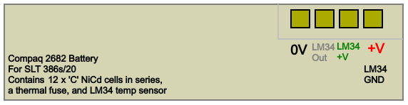

I have a nice Compaq SLT 386s/20, but the power brick has died. (The power brick for the SLT 286 and 386s both look the same, but I am not sure if they are the same)
I have replaced the leaking caps, and tested most of the parts, but have had no luck fixing the power supply yet.
If anyone has a spare power supply, I would love to buy or trade for it.
Alternatively, the pinout to the power supply 6-pin cable (I can't reverse engineer it. Seems 'smart', and there is an unmarked IC in the 'smart' area of the power brick. I have some replacement UC80669 SMPS ICs coming, in case it's a primary side problem).
Or the pinout to the 4-pin battery, so I can power the machine from there temporarily.
I have opened the battery and worked out the pinout.
You can power the machine for testing purposes, with a lab power supply emulating the battery.

Hello!
I've worked out enough of the pinout to get the laptop running with a third party power supply. I don't have a good battery, so I wasn't able to really determine what the battery sense terminals do, or see what things look like when charging. I can dig in a little later after I build a replacement battery; a project for another day.
In the image you can see the pinout looking into the computer. These are the male pins.
1) Battery Sense - I don't really know what this signal does, other than it is related to the battery
2) Battery Sense - I don't really know what this signal does, other than it is related to the battery
3) PS_ON - Connect this signal to ground to turn on the power supply. The laptop doesn't care about this signal, only the power supply.
4) +18V - This is the main power feeding the laptop. This is at about +6v when PS_ON is disconnected.
5) Voltage Sense? - I believe this is to compensate for voltage drop across the wiring. When I disconnect this with the laptop powered, the voltage produced by the power supply increases slightly.
6) GND
I confirmed the computer will power with just 18V connected to pin 4, and 0V connected to pin 6, and all other pins open. This was tested with an SLT/386 and a bench supply.
