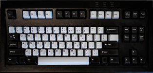

Hiya! Does anyone have or know where I can find an LK421-AA?
Alternately, can anyone point me to a USB or PS/2 keyboard that is laid out in a similar fashion? I can make an adapter using an Arduino so it'll work in my VT340. Unfortunately, it's been hard for me to find any keyboard that is right. The LK421-AA has the control key directly to the left of the letter A, and one-story Return key. It's also cute and small because it omits the application keypad. The "Happy Hacking" keyboard is the closest I've found, but I don't think I'd be very happy with the Backspace key being in a different location.

A USB keyboard meeting your needs shouldn't be hard to find. Google for "TKL keyboard", TKL standing for Ten Key Less, i.e. having no number pad. There are also keyboards without the cursor keys, these are generally referred to as "60%". If the Ctrl key isn't already where you want it, then look for a model with customizable firmware. The QMK firmware is very popular and with it, changing the keyboard layout is just a matter of generating a new firmware image and reflashing the keyboard. If you change the layout this way, you may need replacement keycaps if, for example, the CapsLock and Ctrl keycaps are different sizes. If you get a keyboard using something popular like Cherry MX keyswitches then finding replacement keycaps that fit the MX stems won't be difficult.
I have a Drop CTRL keyboard (https://drop.com/buy/drop-ctrl-high-profile-mechanical-keyboard) that lacks the number pad but has the arrow keys, using the 'standard' layout. I do have a replacement keycap set that includes a larger Ctrl keycap that will fit the space where Caps Lock is, but it doesn't have a smaller Caps Lock key. I'm sure there are keycap sets out there that will have both.
If you aren't interested in the fancy RGB lighting, there is also the Drop ENTR keyboard: https://drop.com/buy/drop-entr-mechanical-keyboard.
While searching I found this keycap set that you might find interesting: https://drop.com/buy/drop-matt3o-mt3-3277-custom-keycap-set
These keys don't have translucent legends allowing individual keyswitch lighting to shine through, but this set does include Ctrl keys in a variety of widths as well as a number of other interesting terminal keys (more IBM-ish than UNIX-ish, alas).

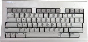

I've also found something called the "Mini Model M" by Unicomp that looks like a good contender if I can't find an LK421-AA.

Yes, updating the firmware would allow you to change the scan code generated by each key, and yes, getting another Ctrl keycap of the appropriate size would be needed if it bothers you to have your Ctrl key physically labeled "CapsLock" on the keycap.
If you go the Unicomp route, they do sell replacement keycap sets for exactly this purpose, although you will probably need to do the scan code swap in the Arduino because I don't know if Unicomp lets you modify the firmware.
Unicomp, Inc.: Alternative Ctrl-Caps Lock Buckling Spring Keys (pckeyboard.com)
Keep in mind that Unicomp keycaps are different from and not compatible with the Cherry MX style so you shouldn't expect to be able to mix and match replacement Unicomp keycaps onto a keyboard using Cherry MX keyswitches.
If you care about the feel of the keys, the Model M has a clicky feel (and sound) *very* different from DEC keyboards. I don't happen to have an LK421, but I did have an LK401 handy and the keyswitches on my LK401 are mushy and silent, with a slight tactile bump at the top of the key movement (like a rubber dome keyboard). I tested a bunch of different Cherry MX and MX-clone keyswitches and the ones I have that feel most similar to the LK401 are Cherry MX Clear, Cherry Tactile Gray, Zealios 78g, and Kailh Box Royal.
