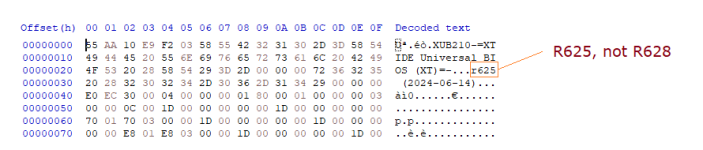

I see that XUB R628 was released in June. When I look in file ide_xt.bin, I see:
Yes i noticed that, A tad confusing but looking at the 'Changesets' i see there has been NO change in code, So essentially R628 is the same as R625 code wise.
I see: In R626 The old 1x configurator was removed for some reason.
I see: In R627 The old 1x configurator was put back again.
I see: In R628 There was a new 'copyrights' text file added
In each new revision there was no code changes made
Over the years any minor update which resulted in no changes to the code had the Revision # bumped up, Maybe this has changed now ?

In the code for the XUB i see: ' BIOS version string (supports up to r999) ', What happens when the Revision # hits R999 and over ?, I dunno, That is, if it ever does of course, I dunno how it works server side either, I assume server side it doesn't have that restraint and can go past r999.

Answering my own question I just did a custom build and raising the revision # to 999 the BIOS builds perfectly.
Raising the revision # to 1000 the BIOS failed to build with errors.

This is a result of the server migration - I didn't realise that the displayed release number was hard-coded in Revision.inc.
This should now be sorted (everything should now say r629) - my apologies to the XTIDE Team for the unnecessary releases and the user-base for the confusion..
