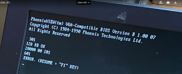

Evenin' folks....soo... by way of an update his is what's going on:
1. replaced The Two Troublesome Tantalums (c58 and c56)
2. replaced that variable ceramic cap
3. Re-applied power. SUCCESS!!
4. Added cards in one-by-one:
CGA card (running through composite, 40 lines)​
Keyboard​
AST Six Pak​
HD controller​
Floppy controller​
5. As I added cards I got more errors. I also believe my PS2->XT converter keyboard is not gonna cut it. Here's the current list
301 - keyboard (same error with or without keyboard attached)​
20000 201 - memory problem at 20000​
1701 some general HDD or Controller problem​
601 Floppy (well in fairness the floppy isn't even there)​
6. I just received my ISA Cirrus Logic VGA card from ebay and interestingly IT WORKS - but only if I configure the switches for MDA, not VGA. Weird huh?
Special note: I believe my final step to add floppy drive caused a sharp, burning component smell. I immediately powered down, but despite frantic sniffing I couldn't locate the source.
Anyway, HDD and Floppy seem to be toast right now. And the keyboard. Oh, and memory location 20000..... apart from that we doing great!
cheers! Andy

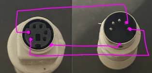

And might the problem be your "PS2->XT converter" !
Confirm for us that it is an active device like [here], not just a cable with different connectors at the ends.
According to my cheap multimeter I am going to make the assumption that my xt-ps2 dongle is just a few wires connected ... without any circutry.
You may have made the same mistake that I made, and that was assuming that a PS/2 keyboard would work on an XT with a PS/2 to DIN adapter. But the protocols used by the two standards are different enough to not be compatible.
I built an AT2XT keyboard adapter on some strip board and that has been serving me well so far.
