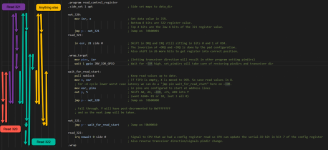

The programmable IO program for control register reads is now implemented. Port 321 and 322 are returning expected values. 320 and 324 are not responding as expected. This is with my 486 ISA bus overclocked to 16MHz and the timings seem to be (just) good enough.
I have to say, while using the programmable IO on the Pico is super interesting, I am not sure I would recommend others follow. Hard, low-level programming is my day job and I am finding this slow going and quite challenging. I think it would have been much easier for me to use programmable logic, and say, a STM32. And I am just a tinkerer with programmable logic. With PIO, you just need 10 or 20 crazy tricks and after that it is smooth sailing.
The control register read program has all sorts of tricks going on. Complicated branching and fall-throughs. Pins in just the right order so I can use decrements for decoding, or so bits are in just the right spot when needed to shift into another register. Look at this program flow I annotated for it:
And there is a second program that watches for when this one flips the transceiver direction.
