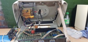

New toy picked up

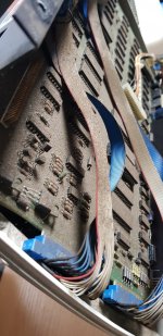

Reported as emitting a loud pop when they turned it on so some work to do. Shame the case didn't follow the hinge from the front design of previous machines, but once open, boy is it filthy inside.
Initially looked like the transformer had failed

I think you want a tetanus jab before touching that :)...
That is the worst thing I have seen for a while (close to things in the dead pigeon loft)...
Its a bit manky :)
At least being basically an 8032, it should be saveable and it seems to be largely corrosion free which suggests its not been in a damp place.

DIY lid prop fitted
Board powered up but no response. 5V rail measured at ~1.8V then UE4 decided to call it a day. Interestingly, this was the IC directly below the exploding mains filter so might have been shorted underneath by carbon. Time to whip it out and give it all a more thorough clean
