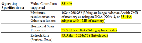

Well, my IBM PS/2 8560 'restoration' project is coming along. Not so much restoring it, but 'tricking it out'. Anyway, I got hold of an 8514/A with memory expansion, and it works great, except that the display I hooked up to test with does not support the 1024x768 43Hz Interlaced video the 8514/A puts out. And the IBM 8514 to 8517 displays are a bit on the rare side. So I'm trying to find some other display that can work with what the 8514/A puts out. Best would be an LCD display. If anyone is aware of any compatible displays that might have been marketed, I'd love to find out. Thanks

Well, this is what the specs for the display need to support. I suspect I will wind up looking at some kind of video scaler/converter though.
