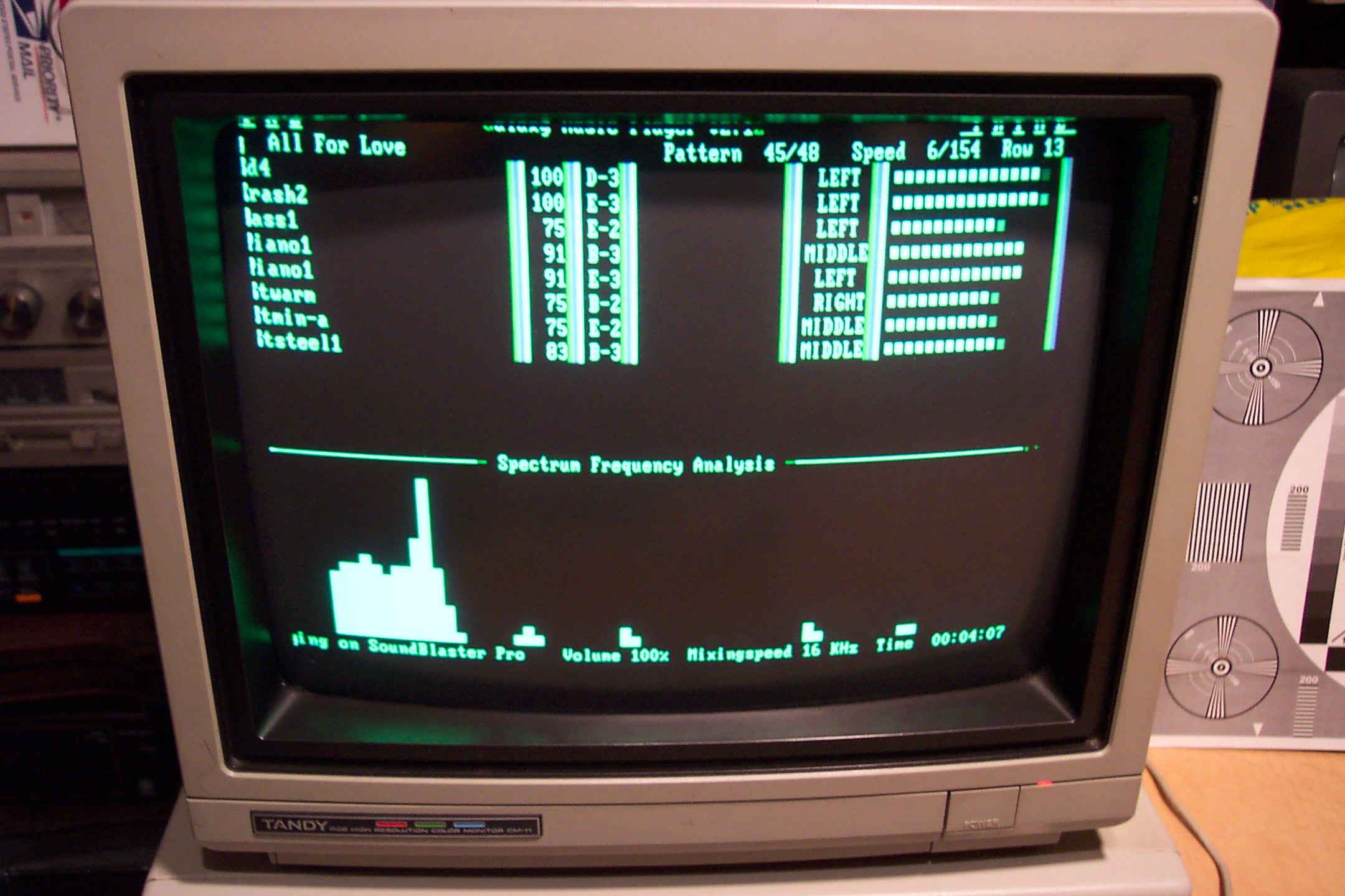

Wait, you didn't have to tweak the video processor settings?
Are you saying it just normally outputs color video all the time, except A: Normal mono programs don't write color attributes, and B: The sync and resolution is not compatible with "standard" TV-resolution RGB monitors, therefor requiring a Multisync or similar?
Oh I think I found it you connect missing U30 to U63 and missing U63 to U64.
The pins were correct there are resistors in the middle my bad :P
Yep! As long as you have an early MDA card and a multisync monitor, it just works. However, programs that "play nice" will see that you've set the monochrome switch and not generate color attributes.
The later Tandy 1000s will output MDA/Hercules video on the green pin as well as the normal pin 7 monochrome video output. This allows you to almost successfully display MDA on a CGA monitor if you tweak the controls far enough (as shown below). I wonder if these also have latent "color MDA" capability?
I wonder if you multisync interprets the signal as EGA (thus 6-bit) or CGA-like RGBI. Because if it was EGA the colors will be off. Can you draw a colorbar ?
Are we talking about having to add wires to the original version, or just the later version?
he is talking about adding the wires to the later version (the early doesn't need them).
Connect all missing lines for R, G and B across U30, U63, U64 and the DB9
