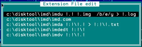

As I have some P2 floppydisks I can make images of them.
I don't know what the content is. Some are for P2 native, some are for booting CP/M I believe.
I can make images with Dave Dunfields' IMD if you are interested.

As IMD made compressed images you can't look into them with a hex editor. With IMDU you can convert to raw images - I called them bin mostly they are called img as in the picture below.
For easy use with Msdos I have the Norton Commander and some user commands.
For IMD there is a nice pdf at https://oldcomputers-ddns.org/public/pub/manuals/imd.pdf
