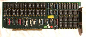

HDC and RAM expansion board pics attached. RAM board has 2 meg of OKI 511000-10 (100 ns?) with empty slots for 6 meg more.
-CH-
