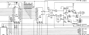

I found the Apple II Schematic and the 2732 ROM has A0, A1, A2 (the first 3 address Lines) to select from
2 ^ 3 = 8 Address {0..7} = 8 Bits for the first character. Of that 8 Bit by a Row Character only 7 rows of
{0..4} = 5 Bits are used for the Character.
Larry

A0, A1, A2 = 3 Bits that select 2 ^ 3 = 8 HEX Bytes to be read in a repeating pattern from the
2732 EPROM.
This matches what is in the chargen-lc.bin file.
Larry
