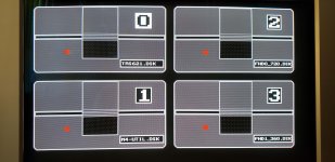

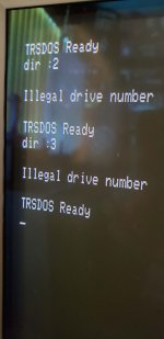

Okay, my floppy drives are DS0 is a 1.44 and DS1 is a 1.2. I have floppies in both and I set them up as shown in the first attached pic. When I try to access them, I get what is shown in the second attached pic.
Either it is not working as intended, or I'm just missing something and need to focus more.
Seems that the drive number 3 is not enabled in TRS-DOS ... please execute SYSTEM (DRIVE=3,ENABLE) ...
