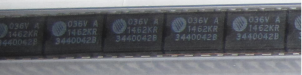

Some years back now, the clock chip in my IIgs failed.
I was able to source a compatible replacement through a broker. (3440042B is from a MacPlus, but works just fine).
Had to buy a tube of 20 though :rolleyes:
