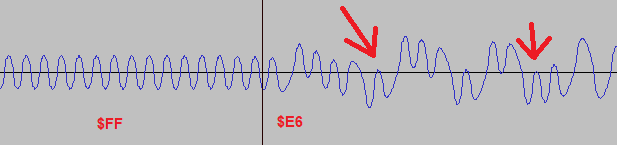

Hi,
I join this thread as I'm also involved in trying to decode the audio message contained in the "Bermuda Triangle" LP recording.
The Tarbell format is simply data bits manchester encoded: "01" decodes to "1", and "10" to "0". First decoded bit is the most significant of an 8 bits byte.
Since there are two pulses per data bit, special care must be taken in order to decode in sync with the first pulse and not the second. On the interface this is achieved by keeping a "clock" derived directly from the raising edges of the rectfied audio signal.
Clock is assumed to be acquired when there is a change on the data bits (from 0->1 or 1->0). To achieve this, the tape recording starts with a leading sequence of $FF (all 111...) and then the byte $E6 which provides the needed bit change in order to acquire the clock.
Of course when decoding in software this complex clock acquisition resolves into just looking for a pulse "0110" or "1001".
I wrote a decoding program in JavaScript which I previously used for another Tarbell cassette file, the "Tarbell BASIC 1.5" (I think there is a post on this forum if I remember well).
The problem with the "Bermuda Triangle" LP recording is the bad quality of the audio (which is surprising if we consider it comes from a remastered source put on CD).
If you look at the attached picture below you can see the exact point after the $FF lead where the $E6 byte should be. You can see how some short pulses are below the zero level making them disappear when the signal is quantized.
To make the signal less "wavy", I tried to apply different high pass filters with limited success; some clear text starts to appear but most are corrupted bits.
This is what I get after applying a 400 Hz high pass filter 12db rolloff:
And this with 600 Hz high pass 6db rolloff:
To be sure the issue is in the quality of the audio source, I did a plot of the pulse lengths distribution. Since the input signal is manchester encoded, there are only two possible pulses: the short one is 3000Hz (14.7 samples at 44100Hz) and the long one 1500Hz (29.4 samples at 44100Hz).
In a clean signal the plot should be made of two gaussians centered at 15 and 30, with a clear separation between the two; the more separated the signal, the better the overall quality of the audio.
But as you can see from the plot below, there are yes two gaussian distributions, but they do overlap considerably with no distinct division between the two. That results in "0" bits decoding as "1" and vice versa.
So apparently I am at a dead end with this one. The only possibility which I can think of is to apply some filtering in order to restore the quality of the audio.
Do you have any suggestion?

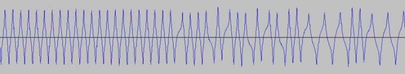

I would suggest peak detection. Every time the signal changes direction thats a peak, so flip the result.
It ignores baseline shift. Of course you loose polarity but can recover that by looking for SYNC or not SYNC
to get the polarity
joe

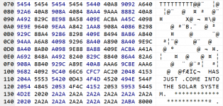

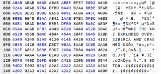

thank you Joe! while thinking about your suggestion and how to detect peaks, I calculated the first derivative to the audio signal and suddenly realized I had a quite clean signal to work with. So I applied a wideband low pass filter (4000 Hz) to let only the information pass through.
This was my clean signal in the exact same spot after the leading sequence:
I then fed it to my decoding program and ...voilà! The whole text fully decoded!
**********  THIS IS THE BERMUDA TRIANGLE, OVER. LOOK OUT!
THE CYLINDRICAL OBJECT JUST LIKE THE ONE EXPLODED OVER
SIBERIA AND CRASHED INTO TUSNGUSKA IN 1908,  HAS JUST
COME INTO THE SOLAR SYSTEM.  ************  ***********
this is the hex dump, note the $3C $E6 start bytes and the two bytes checksum at the end (still to be verified).
