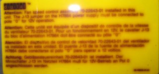

This is the sticker telling how to configure the fan supply voltage for use with the fan speed control:
The blurredness is NOT the photo, the sticker quality is that bad!
