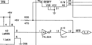

So, what does no SYNC on the CPU tell you where to go next?
I suspect that I might have problems with the reset signal...
The signal should be low when turned on for a few moments and then go high, correct?
I have always LOW signal on CPU pin 40, and i have LOW also on A10 pin 12,14 and on A3 pin 2. I have HIGH signal on A3 pin1 and A2 pin 3.

Obviously, something on the NE555 reset circuit isn't working correctly is it?
Check the logic levels on A2 pins 1, 4 and 8 using a logic probe.
Then check the voltage levels on A2 pins 2, 6 and 7 with your oscilloscope.
We then need to think about a faulty C67, C68 or A2 (NE555)...
Before replacing anything, however, check the solder joints and PCB tracks for damage around A2 and the associated components. Someone could have been playing before you...
The pull-up resistors (R16 and R15) are OK then.
What happens on A2 pin 3 (the output of the NE555) if you short A2 pin 2 to 0V via a 100 Ohm (or so) resistor?
Hi Dave, yes you were right as usual, the 555 was broken. I changed to a new one and now it works!
