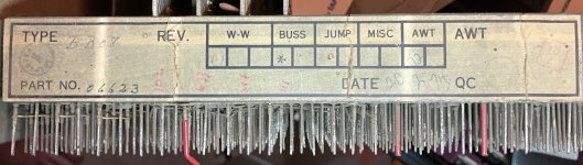

However removing the modules showed a DEC factory plate.
What is a BB08N? Didn't see anything in the 1970 Small Computer Handbook about it, maybe it is their nomenclature for a generic module just as a BA08 is a generic box?

More data: Looks like it was made in Feb 1973. Pretty late all things considered, I'm not sure if anyone was using Negibus at that time. So it might "work" on my 8/L.

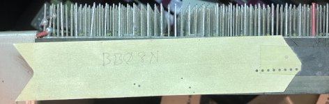

Someone really wanted us to know it was a BB08, maybe this was a DEC job?

Looks like a great candidate for some backplane tracing! I have never heard of it before, but the N on the end probably suggests Negibus. I'd say 8/I folks were certainly still using their Negibus systems when this was built.
BB08N does suggest Negibus, as do the M102 device decoders, M100 Negative bus receivers, and M663 Negative Bus drivers. There are Posibus equivalents (M103, M101, M661) if you wanted to convert it for use on your 8/L.
The rest of that are just gates and latches. I can't but wonder if something was meant to plug in in addition to the 8/I cables. Are there any empty-but-wired slots?
Interestingly, the presence of two M102 seems overkill (two 6xx device codes) for what seems a very simple device.

A little info found in Option Module Listings:
BB08-N bus interface with 24 unwired slots 8 Neg
BB08-P bus interface with 24 unwired slots 8 Pos

Here we go. It's described in:
starting on page 294 of the PDF (Posibus version).
Yep, that looks like it. It's basically a pdp8 version of a VaxBI BIIC :-)
Looking at the wiring I can see that there are user installed wires going over to slot 9 and that's it, so it was probably a custom interface to a pdp8/L with basic parallel input and output.
