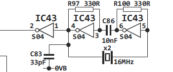

Got my master PSU up and running but the Master itself is very sick :)
The circuit diagram has a 16MHz oscillator that outputs through a 74S04
Then this goes to a video processor that also outputs various clocks and the 2MHz clock is used to run the processor
Pin 2 of IC43 is not showing anything like a 16MHz wave so I suspect this circuit. The gate IC tests ok although the Hex inverter actually fitted to my Master is a 74LS04 rather than the 74S04 specified in the manual but I doubt that should be causing the problem as 74LS while slower, should be ok for 16MHz I would have though ? This clock is then split at the video processor into 1,2,4 & 8 MHz clocks and none of them are stable and the whole machine is going crazy (the cassette interface relay clicks like mad !)
So maybe a failed capacitor. Thing is, the capacitors in the service manual are listed as CPLT, which I cant work out what they are.
0631,033 CPCTR CPLT 33p 3V 2% C83
0631,100 CPCTR CPLT 100p 3V 2% C86
Anyone know what a CPLT is short for ?
I probably can use a Mica capacitor I think, can get them in 2% tollerance but RS want £30 for one 10nf unit ! but I also note the discrepancy between the drawing and the parts list
The caps themselves have 33 and 10 written on them, so I am inclined to believe the drawing but is 10nF too big ?
Gary,
I don't know about the CPLT (but ceramic plate ... comes to mind).
The 74LS (to my mind) will be too slow, and why the 74S would have been specified in the first place.
Thanks Dave, you are probably right. I have ordered some 74S04's though I suppose some HCT's would have done the trick but might as well stick with the original spec.

I tend to agree with Daver2 that it will have been specified as 74S04 for a reason, when it would have been easier just to use a standard 74LS series otherwise.
Yes, already tried pin 2 disconnected to make sure it wasn't a problem down stream.
But this morning, got the S04's and put one in before I went to work and on power up the cassette relay clicked once, indicating its been addressed correctly. Didn't have time to connect up anything else or check the output on the scope but its looking better.
As you say, its an S04 for a reason, 16MHz gives a 62ns cycle, and an LS switching is about 30ns, so marginal especially once propagation is factored in by the looks.
