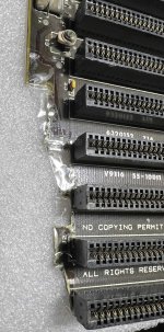

The reason I'm searching for the board layout is , I want to repair a damaged board, the PCB was broken, sadly.
I want to find the layout and recover the wires, mabe crazy, still trying.
if i got some info about original board layout, then this work will be pretty easy.
Here is my board:
