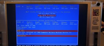

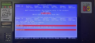

Because someone asked for it on vogons... book8088 v20 vs pocket8086 v30...

Interesting that you had different results with a V20 vs 8088. My approach was to set a single pixel in the top left / bottom right for graphics mode, and a white cell in text mode. So far it has worked on my machine. I'm interested to hear if the TSR works for you.
I wonder if there are different variations of driver boards used. My VGA machine will center correctly on boot but will consistently be offset when switching to graphics modes for certain games. For example, Space Quest 1 will switch between text and graphics modes during the starting sequence. The text mode for entering your name is always way off to one side, which seems to be because the screen is mostly black. There is also an issue in Commander Keen as the border / background colour is changed from black to cyan and the display locks on to the edge of the overscan region, cutting off the bottom right of the screen. Prince of Persia is hit and miss with centering correctly. When starting, it shows a 'loading' message centered in an otherwise black screen which appears to be the issue. (Prince of Persia has a problem with the VGA palette routines but that appears to be a different issue entirely)
My TSR fixes the issues for these games, at least on my machine. :)
I was haveing the exact same issue you described in Commander Keen, and also in any other game (screen shifted to the left). Your TSR solved the issue on my machine as well. Big thank you for your effort!
