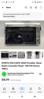

Here's the walkman clone I ordered for the "holo-tape" reader. It has a built-in radio so I'm killing two birds with one stone, knocking the radio and the tape drive off of the list:
It says parts only, but that's because the battery bank is slightly corroded, the description says it still plays.
