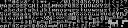

Gotta wonder if you could get a mostly 320x200 image (with some artifacts and color clash)
By using more of the available text character options ?
Would have to map useful characters for filling the bottom / top (2lines) only and the center
Would need to look at the top row of all characters to see what options are available.
