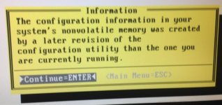

I tried SoftPaq 1363 before. After booting, I'll get the message "The SETUP program does not support this machine" :(
The set of Compaq disks seem to be a lot more effective.. thanks! But..
After running "Compaq EISA Configuration Utility Ver. 2.06" disk, I'll choose "Configure computer" from the menu. Unfortunately, after loading I'll get this message:
When choosing "Continue" brings me to the main menu again...
So it seems like the owner before used newer software that avoids me to configure the system. Any idea how to fix this? Will a bios reset help?

Finally I found the right SoftPaq! SP1855 does the job! It's an older version of the configuration utility..
One step further, but again another issue..
Yesterday I runned the config utility of this SoftPaq. I couldnt save the new settings for some reason, so I decided to reboot and run the utility again.. The utility uses MS-DOS, and with booting the system stopped when it tries to load DOS. I tried another DOS boot disk, but it gives the same problem..!
Anyone common with this issue?
