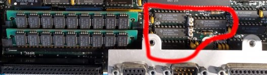

Edit: I found the missing 128KB, they are right next to the RAM sockets:
I guess the chips themselves or something on their path is bad, and I need to debug this. Leaving the rest of my post for posterity - thanks everyone for being my rubber ducks. :D
Any suggestions on how to debug the broken chips welcome.

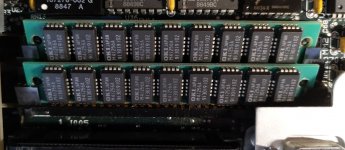

The mainboard takes two 30-pin SIMM RAM modules, in the bottom middle:
These are populated with 2x256KB modules (I googled the markings on the chips). Here's a closeup:

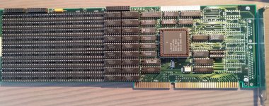

There's a third memory card that came with the computer, but it was a regular ISA card that was installed in the external ISA extension box. However, the ISA extension module seems to have a short that I have yet to debug, so I haven't been able to see what happens when that card is plugged in.
This is the card, holding what seems to be 2MB of RAM in 18x1MBit chips:
Given that it has to be installed in the optional, bulky ISA extension box, I highly doubt that the "default" of 640KB base RAM requires such a card to be present.

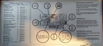

The configuration stickers in the case don't bring any clarity for me:
  1. The "No Extended Memory / Select Address Bank XXX" jumpers in the left image control how much of the RAM on the expansion board (RAM2) are configured as XMS. One can have none, some, or all banks configured for XMS; the rest becomes EMS. I've tried various combinations, nothing added more base.
  2. I'm not 100% sure what DIP switches 3 and 4 control exactly, since I don't know what "640KB + XXX" is supposed to mean. I've stuffed 2 1MB SIMMs into the mainboard sockets and tried various combinations of these, but I never got it to recognize more than 512KB.

Okay, I just spent a painful evening hunched over my bench testing and checking and comparing against a working unit, and I found multiple broken traces AND a faulty U71 - 74F280 9-bit parity generator/checker
I'm pretty sure the U71 is the actual culprit, and I can't really verify whether the broken traces were my own fault during rework, or previous damage. Either way, the board is a pile of bodges and now I'll have to hunt down a replacement 74F280.
Having said all that, during my debugging, I made a table of the fault codes when different memory chips are removed. 080000 F000 seems to mean that U58 of the onboard 4464 RAM ICs is missing/faulty, so hopefully that's your problem!
