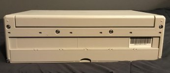

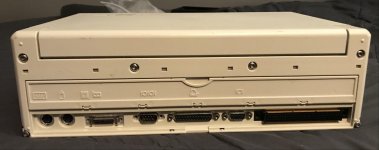

I still have those two images in my ebay inbox, so here they are. When I saw this, I was in disbelief:
![Click image for larger version Name: sltproto2.jpg Views: 0 Size: 230.0 KB ID: 1219316 Click image for larger version Name: sltproto2.jpg Views: 0 Size: 230.0 KB ID: 1219316](https://forum.vcfed.org/data/attachments/56/56086-79c5322a54e5de5a04c4ffb23843ebf2.jpg)
The first pic shows an unusual and somewhat crude-looking looking serial number sticker, and a complete lack of identification labels. The second picture was the real shocker for me, IT HAS A MOUSE PORT!!!! No production SLT ever had a PS/2 mouse port. Period. At this point I knew I had to get this laptop one way or another. The seller did come down some on his price, so that was good.
I was eager to get it and fully disassemble it to see what differences were hiding inside!
