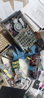

I'm trying to confirm my SA850 drives can access the 2nd head and am having lots of trouble.
Adaptec 1522CF on a DOS PC with imagedisk and 22disk and anadisk.
No trouble reading/writing 5.25, 3.5 drives.
I'm using the S2 option jumper, everything looks right.

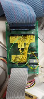

I SHOULD be able to FORMAT B: /F:360 and succeed but DOS 5.0 and 3.31 spit out error m20241009_162653.jpgessages when they get to the 2nd head. Not read.I've tried my own DIY 34-50 board, the DBIT and the texelec, with all the same results.I've tried as many jumper configs as I can think of.
I'm neck deep in this and need to get this resolved before I can confidently tackle the ibex ideas suggested.

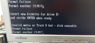

I thought I could just format a DSDD 8" diskette in DOS as 1.2m and have it error out at tk 78
but it tells me invalid media when it moves to the 2nd head on tk 0.
I've tried every possible jumper config, tried every converter board, tried V3.3 and V5 of MSDOS, tried various FORMAT parameters - all fail.

I can not get an SA850 drive to read the 2nd head on a DOS machine.
This drive should act like an 80 track drive up till tk 77 but it fails when it switches to the 2nd head on tk 0.
It formats side 0 then fails after switching to side 1 with invalid media (general purpose error).
I've gone to the effort of building a FD breakout box to help troubleshoot.
The side-select is wired and jumpered correctly
I've tried 4 SA850 drives, they all act the same. Maybe all 4 are bad - strange.
I've tried every known jumper setting.
I've stayed up nights for weeks reading the docs from every source - OEM, service manuals, etc.
If I short the SIDE select signal to always be on side 1 then it fails immediately, telling me that my drive is failing on side 1.
Yes, I'm using double-sided media with the offset index hole, I know this stuff well. I'm getting index pulses.
These 4 drives all read single-sided disks fine on my DOS machine running Imagedisk and 22disk.
I can read SSSD CPM directories.
But I can not read the 2nd side.
I've scoped out the lines and all seems fine. Ready doesn't go away on side 1 select, nor write protect, and I see read data on side 1 at the connector.
This is why my IBEX disks are the same on both sides because I had a jumper setting that was always selecting side 0 so both sides ended up the same.
I'm at a loss what to do now.
Maybe ALL 4 of my SA850 drives are bad on side 1 but otherwise completely work - possible but strange.
