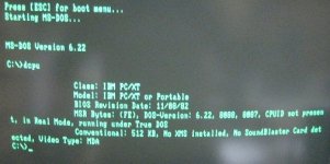

Ok so that's definitely fixed that issue. I ran some tests - here's the results:
On PC/XT with MHS-D8088,8087, MDA, 256K, DOS2.1. dcpu lists PC/XT, V20, FPU, 256K, Hercules.
On Portable (5155), Intel '83 dated P8088, no FPU, 512K, DOS2.1. dcpu lists PC/XT, V20, no FPU, 512K, CGA.
On PC with Intel 8088, no FPU, MDA, 256K, DOS2.1. dcpu lists PC, 8088, no FPU, 256K, Hercules.
On Tandy 1400FD with V20, no FPU, CGA, 768K, DOS3.3. dcpu lists Unknown PC/XT, V20, no FPU, 640K, CGA.
So it seems the later Intel 8088 is being picked up as a V20 and the IBM MDA is being detected as Hercules. The MHS-8088 I will try to find out what it actually is!

For the MDA Detection: Are really sure that no Hercules card is installed? This detection rans 100% successful within DOSBox, my PS/2 M30/286, pce and both 486ers.
For the 8088/V20 Thing: I implemented another method for detecting V30/V20 CPUs.
For the Tandy 1400FD: dcpu only prints the amount of Conventional Memory, not the total amount
Sorry for the troubles, but would you please try this new version ?

hmm, ok. Tried it with PCem with all possible video cards: all get detected correctly (MDA, CGA, Hercules+).
The thing is, that according to pearce_jj, MDA doesn't get detected successful on a real IBM PC.
Maybe later revisions of the MDA also (like the Hercules) set the retrace flag correctly, so this newer revisions get detected as Hercules.
Hmm, I need a modified detection algorithm for MDA/Hercules/HGC+/HGC InColor video cards.
I uploaded a modified version, which prints the value stored in the 6845 Status Register.
@pearce_jj: I need this value, please post it here
