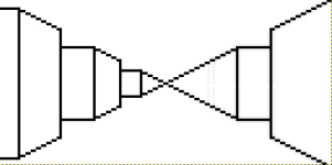

Okay, so some people have DAZZLER boards ... I have a DAZZLER II board in my Altair 8800c computer and want more interesting and maybe even useful things to do with it, such as:
An Etch-A-Sketch program that uses the keyboard "J = Step Left", "I = Step UP", "K = Step Down", and "L = Step Right" keys, then press the "SPACEBAR", enter a color number and hit <ENTER> to place a color DOT in that position. The program could also use a JoyStick, but that may not work as well as the keyboard entries.
Another program idea is a 3D Escape from the Zombies game ... Black & White for the higher resolution. The idea is again using the navigation keys the FPS user steps on each keystroke, IF a Zombie pops into view the user uses the "SPACEBAR" to stun the Zombie so they can try and run past or go down a different hallway. One hallway will be labeled "EXIT" which will exit the game, all others will just transport the user to a new part of the maze.
I have some other fun and I think useful program ideas that makes using the DAZZLERs more fun than just running KSCOPE.
Something that might make the games even more fun is if a 2nd user could dial-IN by modem. I have a PMMI modem in each of my two computers, but I also have a few other RS-232 modems. It would be fun to have some simple games for dial-up users to compete.
I am not a programmer, but now I am trying to learn: https://forum.vcfed.org/index.php?t...anguage-listings-for-simple-programs.1249310/
I would love to work with somebody for testing and program development while I learn the more basic assembly programming myself.
