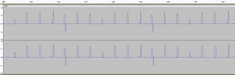

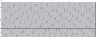

Concerning the z80pack, I luckily got the new version working under Linux. The only drawback is that my D+7A audio emulation doesn't work any more (still need to find the reason why). Could not yet compile the whole package under Cygwin.
Here is how the final wave output for a sinus wave works out with z80pack 1.37 under Cygwin:
And here how it looks like with z80pack 1.38 under Linux :-/
