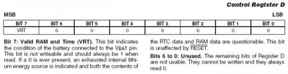

One clue I found on the 'net specific to this computer model is how to query the RTC cell condition which uses register D:
However, you may query the chip directly -- the battery state
is reflected in bit 7 of register D of the chip. For the Maxine you can
get to the register by typing:
>> e -bx 0xbc200034
at the console. If the reported value is "0x80", then the battery is OK;
if it's "0x00", then the battery failed.
But what I need to do to wake up the RTC is write a pattern of 010 in bits 4 to 6 of Register A. Writing to memory uses the "d" command instead of "e".
Does anyone recognise the address format and could offer a clue as to what the command might be?
