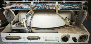

Hello,
Through a very unlikely chain of coincidences, I recently acquired an original Data Disc Model 7206 hard disk. In this post, I will outline what I’ve discovered so far, along with my plans and goals for this project.
From what I’ve gathered, this hard disk was originally designed to work with a 1211 disk controller for the PDP-8. Unfortunately, I only have the hard disk itself, though it appears to be complete and in good condition. Documentation on this model or its interface with external devices has been extremely hard to find.
My long-term goal is to attempt to activate this disk and recover any data that might still be present. I’d greatly appreciate any advice or insights. Please note, however, that this project falls outside my area of expertise, so I am learning as I go. One major hurdle I forsee is the need to reverse-engineer the architecture and signaling of the external connectors, as this design is by now quite prehistoric. More details on this below.
Findings So Far​
Summary of what I’ve discovered about the disk so far (approximately chronological):
  1. Basic Information:
    • This specific unit dates to March 1975, though I believe the design itself originated in 1971.
    • It was sold to Harris, which makes its appearance in my part of the world a bit of a mystery.
    • The drive is a single-platter, fixed-head disk with 64 tracks and 8 spare tracks, divided into 40 sectors. Each sector holds 2,722 bits (110,000 bits per track).
    • The drive operates at a bitrate of 3.3 MHz, which is relevant to all printed circuit boards in the internal controller as well.
  2. Physical Structure:
    • Power Supply: 120V, 50Hz AC via an Amphenol socket.
    • Motor and Drive Assembly: Includes a large transformer at the rear, a 1/20 HP electric motor, and a precision drive belt connecting the motor to the main disk spindle.
    • External Signal Connectors: Two Amphenol connectors (50-pin and 36-pin, seemingly Centronics-compatible). Not all pins are wired, especially on the 36-pin connector.

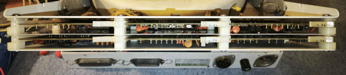

    • Controller Assembly: A six-slot rack of printed circuit boards, primarily containing Signetics quad-gate ICs and flip-flops. One board appears to handle spare track and sector assignments using a jumper wire matrix. I assume the controller translates addressing into signals for the fixed-head arrays.
  3. Disk Drum and Heads:
    • The main disk drum includes the platter mounted on a large bearing, which seems functional and free of major issues. The platter is surrounded by 2 steel rings above and below, with five circuit boards mounted on each. These boards connect the controller outside and to the physical magnetic heads.
    • The heads appear to be handcrafted with extremely fine wiring, making them delicate and hard to access without risk of damage.
    • The disk itself is in good condition, with no visible scratches or damage except for a small crater, likely the one already marked as a spare track in the spare track assignment sticker.
    • A potential concern is a high-pitched resonant vibration when manually spinning the disk at low speeds (20–60 RPM). This might not occur at the designed operational speed of ~1,500 RPM, but I’m unsure if the bearing is self-centering as intended and if the vibration mode is only present at low speeds.
Challenges​
My current focus is reverse-engineering the external pinouts and controller circuitry to understand the signaling needed to communicate with the drive. However, this is far outside my current skill set, so any documentation or guidance would be invaluable.
To aid in this process, I’ve attached:
  • Photographs of the full assembly, all visible labeling, and both sides of the six printed circuit boards in the controller, and the external controller i don't have.
  • A quoted excerpt I found on this forum, which is the only written information I have on this drive so far.
I’m also in the process of tracing the wiring connections between the circuits and the external connectors. I’ll update this thread once I have more information.
If anyone has experience with this kind of hardware, similar systems, or can help with reverse engineering and documentation, I’d be grateful for your help. I’m happy to provide additional photographs, disassemble components, or answer any questions you may have - .

I've messed with DF32 fixed head disks.
https://www.pdp8online.com/dfds32/dfds32.shtml
I've tried to avoid working on things without any documentation so can't provide much help on approaches.
For recovering the contents you could do the same as I did above and see if you can find where the head signal is a reasonable amplitude signal and capture it with a deep memory scope and decode offline. For the DF32 it has a clock track and track which indicates which word is going by along with the data tracks. Sounds like yours just has data tracks which may make it easier but the data will be encoded in some manner to allow clock recovery. Manchester, FM, MFM etc.
For the DF32's the platters tend to be damaged where the heads sit. The manual says to leave drive running to prevent damage from stop/start. If you remove the platter getting it back on with same runout will be difficult which can prevent full data recovery.
Low speed spinning is hard on platter. The heads fly on air cushion when at speed but rub on the disk surface at low speed. The DF32's make squealing noise when heads aren't flying.
Good luck. Its an interesting project.
I can't remember if it was the DF32 or one of the other fixed head drives but the plating on the platter is very soft compared to other metals and if you were not spinning it constantly you were to remove the platter and store it because the landed heads had enough spring tension to leave indents after a prolonged period.
