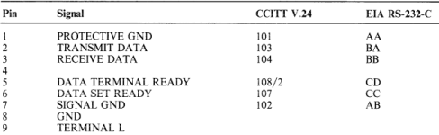

I'm looking to do some serial port work on my DEC Pro 380 in Venix. Anyone know offhand if there's anything special about it, or will a regular straight thru/null modem do?
If you are using the printer port for a serial console, you need to connect pins 8 and 9 on the PRO end of the cable. If you are using the other port, the communication port, no funny cabling required to do reads and writes on it (but, it's just a terminal line - you can't use it as a console).If you intend to attach an external console there is a pin that needs to be grounded. It's documented in the system manual (I'm not in front of mine at the moment and don't recall the exact details).

Thanks, that's helpful. Should it be otherwise a null-modem, or straight through? I'm not sure how I'll hook this up just yet.If you are using the printer port for a serial console, you need to connect pins 8 and 9 on the PRO end of the cable. If you are using the other port, the communication port, no funny cabling required to do reads and writes on it (but, it's just a terminal line - you can't use it as a console).
Pleas ignore the unneeded attachments above - paste got outta control....It's a 9 pin connector, but doesn't use the PC 9 pin standard pinout. Here's what it looks like
THe above doesn't include the connetion between 8 and 9.
I reckon you will need to cross 2 and 3 if you are connecting to anoter system, or an adapter that looks like another system, so that would make the cable null-modemish...DEC 9 pin style.
Pins 2, 3 and 7 should be enough on either one.Do those ports need all the handshaking or can I just get away with swapping Tx/Rx? I have a VR241A and an LK201, but it's nice to have the alternative. I may try this experiment with both ports.
