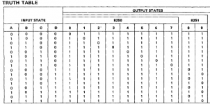

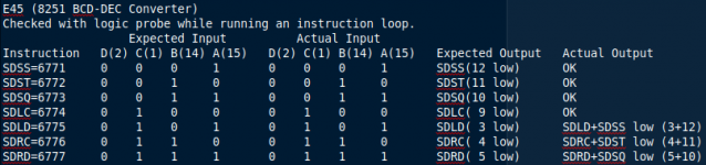

There's an 8251 BCD to Decimal decoder on the controller that interprets the instructions being sent to it by the computer. Rather than decode correctly, it always appears to be converting the two least significant bits to decimal, which produces an invalid state when counting past 4.
I'd actually suspected this a couple of months ago when I noticed the same thing with a logic probe, so I connected my analyzer to it to double-check it. Back then I couldn't reproduce it (perhaps the chip was temperamental then, or I had a poor connection on the clip?), but now it does it every time.
I bought a couple of spares on eBay, they're pretty hard to find now but there's similar enough 7400 series chips that I could probably build an adapter board for one if I had to.

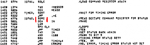

This probably explained the TIMING ERROR STATUS BIT NOT SET IN COMMAND REGISTER error I was getting when running the diagnostics. What's supposed to happen (if I'm interpreting it correctly) is the code generates a timing error, which is set as a flag in the command register, and is then in turn read into the accumulator before being saved in a memory location, which the rest of the code then refers to to run the tests.
If the controller is erroneously executing an SDST (skip on time error) while running an SDRC (read command register to AC), it's skipping over that DCA (save to memory) instruction because the timing error flag is set.
Either way, I swapped the 8251 and the error did indeed go away. After that the error in the MAINDEC went away, and TDFRMT could one again attempt to format tapes.

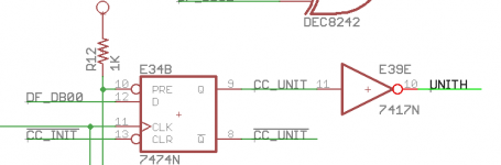

Meanwhile I've tested the flip-flop for the unit select and it appears OK. I then followed the signal to a buffer, and have found that it doesn't always propagate a high signal.
The chip was already socketed, so I tried testing it out of circuit, and also swapping it with a known working one for good measure. I've not seen any change though, so I'm guessing something on the TU56 side is pulling the signal low, as it goes straight from the buffer to the ribbon cable.
