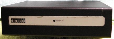

My desktop LSI-11 setup.
A 4-slot dual backplane with an 11/03 front panel, plus MXV11 and a W9512 wire-wrap module giving some parallel I/O and a pair of D/A's.
The fans are 12V, but running from 5V, so they are nice and quiet.
The little MCU board hanging on the left side drives the LSI console, and is a virtual COM port on a PC via USB. It has a micro-SD card for storing PDP code images. The virtual COM port has a 'command mode' for telling the MCU what to do. The MCU also talks to the 11/03 front panel, to perform Halt or Restart, and to drive the 3rd LED (normally unpopulated) in the FP.
Power supply is an H7842A from a Rainbow.
In the space above the FP, I want to add a 7-segment LED display (or similar).
The only code image so far is my hack of FigFORTH V1.3.

Upgrade:
I added a 4-line X 20-column LCD display, driven by the modern MCU board via I2C.
Hooked up the 'SLU 0' from the MXV11 to the MCU, so that it can receive data from the LSI-11 at 38.4K-baud.
Added a little code to the Forth image so that it handles BEVNT interrupts, gets the latest PC from the stack, then outputs two bytes with the PC value via SLU 0.
The MCU then displays the address in the upper-right corner of the LCD. Sorta like an old blinkenlights panel.
