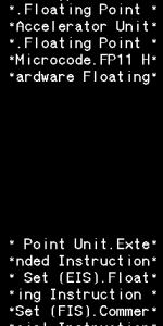

So now I've put together a minimal 11/23 system with these boards:
(L-R: M8186 with KEF11-AA floating point chip, M8059 RAM, RLV12 Emulator designed by Peter Schranz, M8043 serial card). The RLV12 emulator provides a virtual boot ROM. Otherwise, a crippled (RAM disabled) M8047 might have replaced the M8043...

Oh Nice work! - I'm surprised the FPF11 doesn't show as "Floating Point Microcode" rather than FP11 though - Out of interest, where did you source the RXV12 emulator? - I have seen someone doing the RX02 end of the cable but interested in getting a set together - options are always good! - I take it the 40 way interface could connect to a real RX02 drive - or vice versa?
