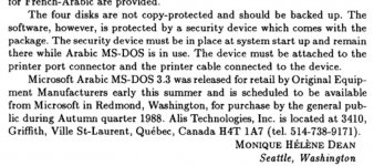

I found an article from 1988 talking about this DOS. The "security device" is required for running this version!

According to the doc fragment Fargo found it's explicitly stated that the security device is a parallel port dongle, which they don't have. How hard it is to break those dongles can vary a lot; sometimes they're extremely rudimentary dinguses that just return a static value when triggered, or do a simple bit-rotation on an input or other trivial task, while others can have ROM or NVRAM with encryption keys, full embedded CPUs, whatever. It doesn't really *look* like from a binary editor that "much" of the code of that disk is encrypted, but without disassembling it it's impossible to tell how often it bangs on the security dongle and what it expects to get back. It may be a simple couple-byte patch to fix it, or it might be a lot more involved.
I'm sure this is a retail DOS version that requires no specific hardware other than an IBM compatible with EGA or VGA video card, and a parallel port of course.
