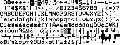

Interesting... what Televideo terminal is that? Did it have MS-DOS support? I see that the full Code Page 437 is there, along with the native(?) and ISO charsets. Sub-0x20 graphical symbols and all:
