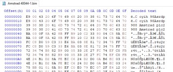

There is something wrong with 'Amstrad 40044-1'.
See below.
( I see 40043-1/40044-1 ROM images hosted at [here], but they contain the code repeated four times [27256 in use?] )
Oh, it's duplicated line-by-line? That's weird! I think that one failed a verify-check.
Have to see about pulling it and trying again some time. Good to hear they're hosted somewhere!

Have to point out that some of the dumps appear to be very partial. In the last archive: 'Cardex1 VGA BIOS' is 8K long, and the two '1993 CIRRUS LOGIC' ones are 8K and 16K (filenames would indicate 64K and 128K respectively, which makes more sense).
Also... others seem to have a single bit constantly stuck ON, which is apparent when you try view them as bitmaps. In these examples bit 3 is always set, which generates those vertical lines:

I had a quick look through, and these are the ones that appear faulty to me:
'Aristo' (bit 3 always on)
'1878-ODD REV-G1-44' (bit 3 always on)
'EISA-S1 U22' (bit 7 always on)
'IWS-4000 REL 2-0 EGA U55' (overdump? - 32K, should probably be 16K; the first 16 are junk)
'64V 3DX BIOS' (too small)
'1993 CIRRUS LOGIC and QUADTEL BIOS-128K' (too small)
'1993 CIRRUS LOGIC and QUADTEL BIOS-64K' (too small)
'Cardex1 VGA BIOS' (too small)
There's also the PC1512 which was already pointed out, and a few others which just contain the same repeating character, but you seem to have noted those in the filenames already ('A4' 'EA' etc).

The sizes would match up if "k" meant bits rather than bytes... just a thought.
Some ROMs might need a chip enable or output enable to be read too. For example the mask roms in my Compaq Portable and Deskpro both needed me to hook up a jumper wire to read them with a generic profile, because my TL866 didn't include a profile for the exact part.

Oh! That's likely the case, yeah. Guess I'll dump that one with the largest generic profile (for the number of pins) and see how that goes.
Hopefully I can figure out whether it's a pin/socket/programmer issue or a ROM-damage issue.
