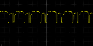

Now, while probing with the oscilloscope, I've noticed that while the address lines look fine to me, the data lines don't look ok, right? See attached screenshot, which was measured at Q0 of the ROM, but it looks the same at the Z80 data lines, or at the RAM data out.
Could this potentially be a bus conflict? How could I now proceed to identify the faulty component?
I've also tried to burn a ROM with all NOPs, but have similar output on the datalines.
