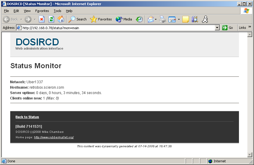

man, you guys are gonna be impressed when i release this software i think. i even have a small built-in HTTP server, designed to allow (password protected) web administration and real-time monitoring of the server.
it's just protected with the standard "basic" HTTP auth method. it can also be access-restriced to a customizable IP address mask. for example, on my network i'd put this line in the DOSIRCD.INI file:
webaccess=192.168.0.*
EDIT: here's a screen shot of IE displaying the dynamically generated main status page. this is very preliminary, and i just started writing this web admin code a few hours ago. there will be a lot more in there when it's done.
:mrgreen:
for the web interface, i'm planning stuff like viewing the whole online client user list with detailed info if you click on one of them. ability to kick/ban from server from the web, etc, etc.. you will be able to directly modify the *.INI configuration files right from the browser, save changes, and have it reload the new configs all without shutting down and kicking everybody off of the server. yes, i am the undisputed master of QuickBASIC thank you for asking. i've been working verrrry hard on this IRCD, so you'll have to excuse my short gloating moment there. it's just great seeing it all start to come together and be stable.
i think it'll be ready to download for the public before august.
it'll be nifty. i'm doing it using HTTP 1.1 keep-alive, so updates are always live and real-time.
