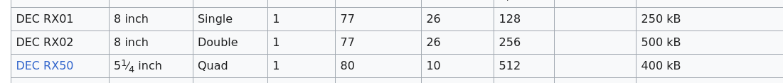

Hi Folks, I would like to use RainDOS to format 5.25" floppies on a 386 PC to use on a DEC Pro.
I need the correct track and sector count: FORMAT a: /T:80 /N:??
Probably other parameters are required.
Any assistance is appreciated.
Well, drat. format a: /t:80 /n:10 results in error: Parameters not supported by drive. I swapped in a second floppy drive with the same results.
