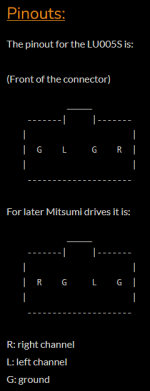

According to this article for the LU005S from July 24, 2021, it looks like I need the driver file MTMCDE.SYS which it links to.
Also according to that article, the Mitsumi CD audio cords were standard shape, but non-standard pin order (even among their own models), and using a cord with pins not ordered properly for it can destroy the CD-ROM drive. 🙄 Well, that means I'll have to get a CD audio cord, check continuity to verify pin position, and probably rewire it.

Connecting audio:
There is another weird quirk you need to know about: the audio connector.
Computers of this age did not have enough throughput to stream the raw audio data digitally from the drive to the soundcard and an analog audio cable has to be used to connect CD drive and soundcard / the Mitsumi controller.
Like there were many different CD drive interfaces (Sony, Panasonic, Mitsumi, ..), each also had their own implementation of this cable.
The later default ATAPI/IDE cable was reversible, as was the Sony cable it was based on: ground leads in the middle with the audio signals on each side. You would reverse left and right channels if you have the plug the wrong way around, but it would work.
The Mitsumi cable however is not reversible: channel – ground – channel – ground.
If the cable is the wrong way around, you would short out the audio and get no sound, potentially damaging your drive. Those connectors are keyed, so you’d think that there is no danger of doing so. However, the LU005S has a different orientation from later Mitsumi drives. Yes. They reversed the pinout of the cable at one point.
If you do not get any sound, chances are your soundcard adheres to the other, later pinout. You might need to desolder the connector from your soundcard and put it back on the other way around.
Check where the signal and ground traces from the connector on the soundcard lead
to, to verify that this is indeed the case for your soundcard.
Pinouts:
